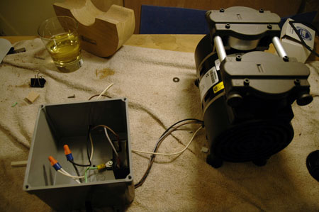

Okay, this is a fairly big guy, but it really isn't loud at all. It sits on 4 antivibration feet, but it'll probably walk if left on awhile. Instructions are included on how to mount the thing a bit more permanently, if you want.
Now, it does not come with a electrical cord. Instead, it has 4 wire coming out of the motor, 2 which connect to an external capacitor that is also provided, and 2 which connect to the mains. So you need to get a project box and do a bit of wiring. I've attached a photo showing what I did. I plan to add a switch to it - right now you turn it on and off by plugging it in and out, which isn't too cool. However, my outlet has a switch so it works for me for the moment.
It doesn't come with plumbing, gauges, etc. I bought the builders kit. The total price is still less than comparable 5CFM commercial units out there, so I feel I did good. I haven't used it yet, though, but it sure does seem to pump better than my current 1CFM pump.
